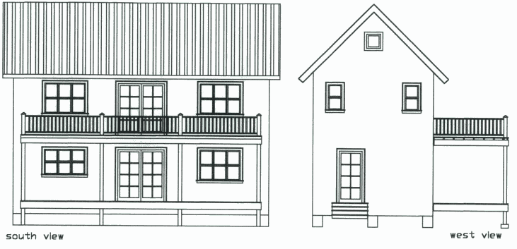

A 16 by 34 foot two story home in the Virginia mountains, designed by Susan Webster from the Victoria’s Cottage plans and built by her family.
south and west elevations of the 16x34 two story cottage, with a full width porch and a deck above it

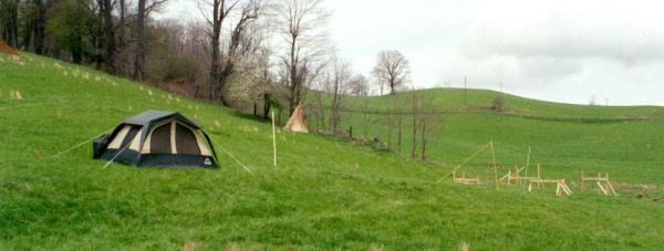

The story begins...
a tent pitched on a green hillside with stakes and batter boards laid out for the house
First camp at the building site.

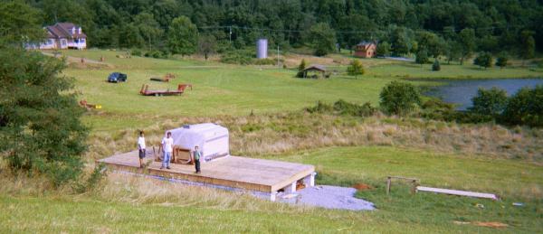

the framing package stacked on the newly decked first floor above the block foundation, with a pond and pasture beyond
Foundation is in and the first floor is decked. Now we have a place to put the next part of the framing package.

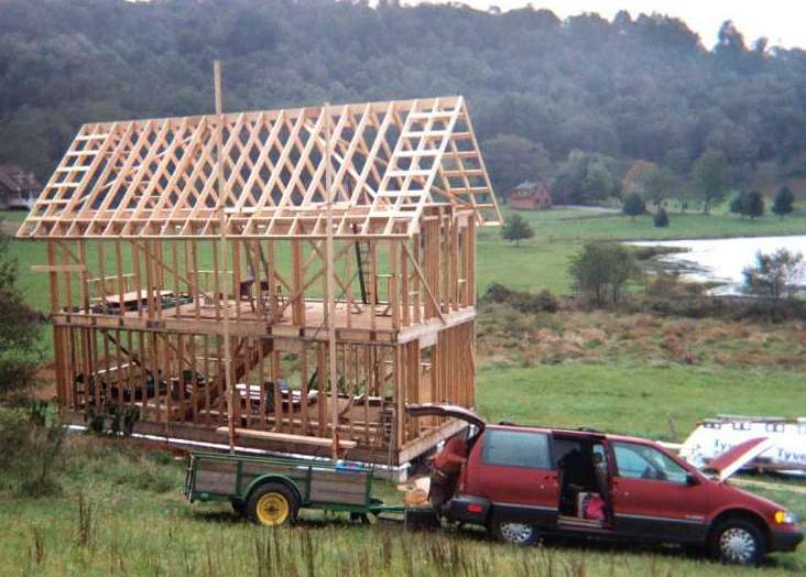

the two story frame and roof rafters standing open on the hillside above a pond
Not a bad little view from that second floor!

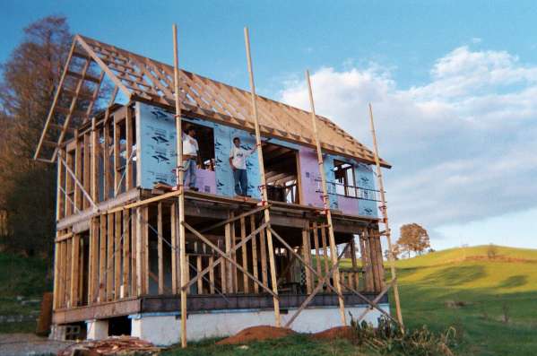

foam sheathing going on over the two by six walls, with scaffolding around the house and the porch framing in place
Insulated foam sheathing will add even more to the R-21 2x6 walls.

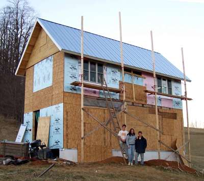

the house with its galvanized metal roof on and structural sheathing part way up the gable end
The roof is on, a few windows are in and structural sheathing is going up.
Plans - Click here to download the PDF file with the floor plans and elevations of Susan Webster’s owner designed house.
