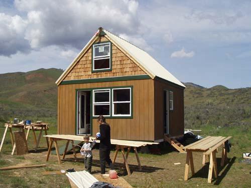

the finished 16x16 cabin with a cedar shingled gable, board siding and a light metal roof

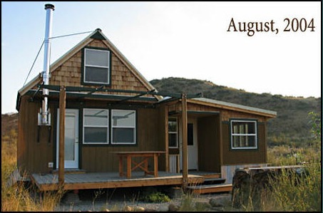

the same cabin in August 2004 with a shed roof addition and a covered porch along the side
Note: Several years ago, the owners bought our Little House plans and sent us the photos and narrative below about building their cabin. We have just recently visited their website and are posting the addition photo above.

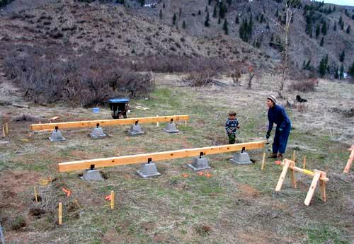

hand dug pier foundation with pavers, piers and the main beams laid out on the building site
We didn’t hire any skilled labor, had no excavators or anything heavier than my Toyota truck on the site and even had to walk in until our driveway was done. We worked without electricity for the first half until a generator was acquired. This was no problem as long as one has a real sharp handsaw and a cordless drill. Of course it took longer, but the quiet, old fashioned way of working was something to remember.
The foundation is hand dug holes 20" square, 16" deep and filed with gravel. On top are pavers and piers. It’s just like John suggests in the plans and is so easy to do. My contractor friends call this a ‘hillbilly’ foundation. We got the piers with adjustable brackets for super simple levelling of the main beams.

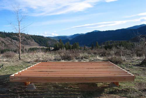

the square 16x16 floor platform framed with 2x10 joists and set on the pier foundation
The floor is framed with 2x10’s and has R30 insulation We changed the floor plan to a square 16x16 layout. The 16' width gives even me, at 6' 3", standing headroom in the loft. This meant adjusting some lumber scantlings here and there and upgrading the foundation with a few more piers. It’s a full loft with a trap door so we have a total of about 400 sq ft of usable interior space. With the windows in both gables and a yellow painted ceiling, the loft is a bright and well ventilated space — a perfect bedroom.

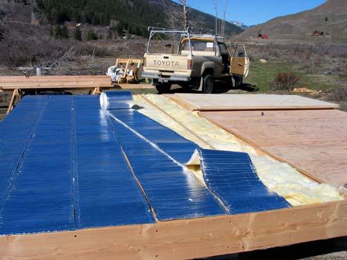

foil faced bubble wrap and batt insulation going into the floor system, with the pickup truck parked behind
We have a very cold winter climate so we framed the walls with double walls of 2x4 @ 2' OC which gives you R13 + R13 with no thermal breaks as the studs are staggered and there’s full insulation behind all electrical boxes etc. The roof is framed with load bearing 2x8’s (R21 w/ room for a vent space), and staggered 2x4 sleepers on the bottom side (for and extra R13). There’s Reflectix foil-faced bubble wrap under the roof sheathing as a first barrier against the hot summer sun. It is also used as the vapor barrier in the floor system (seen above).

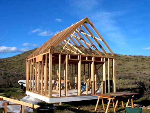

the cabin framed up with steep pitched rafters set, seen from the gable end
All windows are low-E and the design is as passive solar as possible without being having the ability to use tons (literally) of thermal mass. We wanted the gable ends on a north/south axis so we could have as many windows as possible on the sunny south side of the cabin without compromising a load bearing wall. This design also accommodates an easy add-on of a future 300 sq ft addition going off both the east and west sides as shed roof additions. To further maximize the loft headroom we lowered the downstairs ceiling to 7' 6", which also makes it easier to heat in the winter.
Instead of resting the loft joists on the top of the top plate, I bolted them into the studs directly under the plate (so they work as collar ties) and carried the load to the floor with 2x2’s sistered to the studs. We attached the rafters to the plates with metal framing anchors.

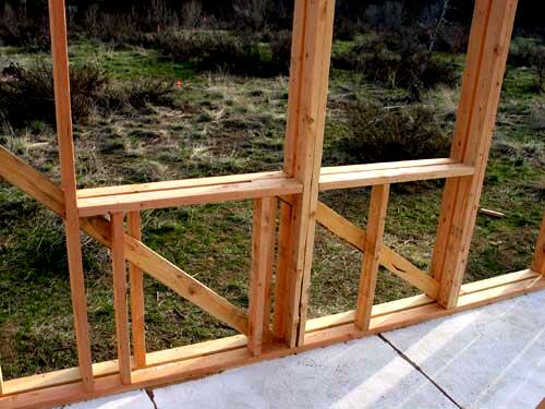

staggered double 2x4 wall framing at a corner of the cabin, seen through the open studs
Here you can see the double 2x4 wall framing.

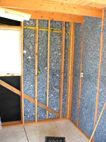

interior wall cavities packed with grey cotton denim batt insulation and wiring run through the studs
We used cotton batts made from denim scraps instead of nasty fiberglass insulation. This makes the task of insulating quite tolerable instead of being a dreaded, dangerous chore. I definitely did a better job than I would have with fiberglass. It is more expensive but when you’re building small it’s all very affordable.

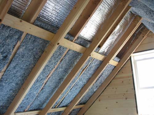

loft roof insulated with cotton batts between the rafters and foil faced bubble wrap above them
Here you can see the foil-faced bubble insulation above the cotton batts. The second layer of batts will go in the inside 2x4 cavity.

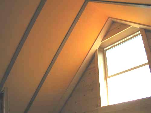

finished loft ceiling in strawboard panels with a bright gable window and pine boards below
Not wanting to have anything to do with drywalling and finding a full tongue and groove pine interior a little overwhelming in both appearance and cost we had to come up with an alternative. And we found it in strawboards, a sheet material made of compressed straw (a waste product) put together with a non toxic, formaldehyde free binder. We bought 20 some sheets @ $13.00 ea and had the interior panelling up in no time. The seams have battens on them made from ripped lenghts of strawboard and there’s sections of T&G wood in select areas like the loft gables, and the bottom 3 ft of downstairs walls — areas that will get the most wear and tear.
The downstairs ceiling is also the floor of the loft. It is a single layer of 1x6 T&G pine boards supported by the exposed floor joists @ 2' on center. A more conservative material would be 2x6 T&G, but we found this 3/4" thick floor to be amazingly sturdy and fully adequate as a loft floor.

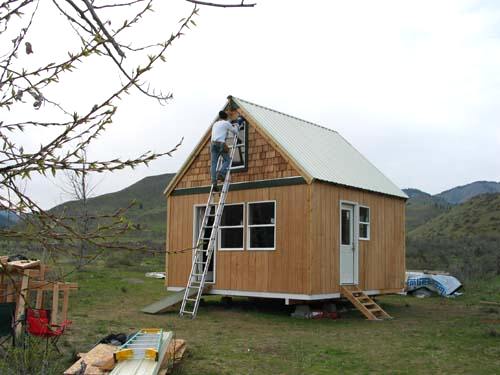

cedar shingles going up on the gable end from a ladder, with the siding and metal roof already on

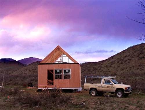

The siding is a T1-11 derivative called Breckenridge, which locally is actually less expensive and far more attractive. It looks like it’s faced with Okoume, a tropical wood also used on marine plywood and hopefully sustainably harvested. It’s shear and siding all in a single layer, so that stage goes fast. We stained it with a semi transparent water based exterior stain. I used a similar product combination on a garage at 8600' in the Sierras, where there’s plenty of snow and rain, pared with intense sun, and it stood the test.
We chose metal roofing simply because 99% of all houses here use it. Installing it was the most challenging aspect of the whole construction process, mainly due to the steep roof pitch. My brother-in-law provided a much needed extra set of hands during this process. Thanks, Ralf. An advantage to metal is that it is available in light colors to avoid overheating in the summer. We went for ivory, which looks awesome and hardly gets warm even on 90 degree days.
