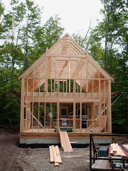

site built trusses framing the 20 foot wide 1-1/2 story cabin
Here you can see the site built trusses.

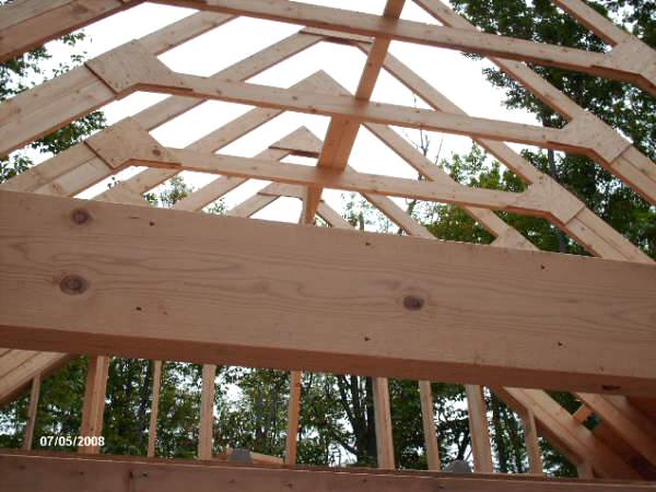

trusses
Looking up into the trusses

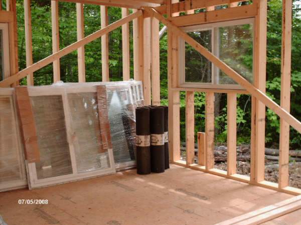

corner framing
Corner bracing and 2x6 framing. Windows going in.

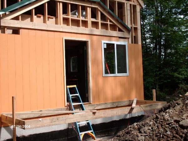

framing and flashing for hip roofed porch
Framing and flashing in place for hip roofed porch

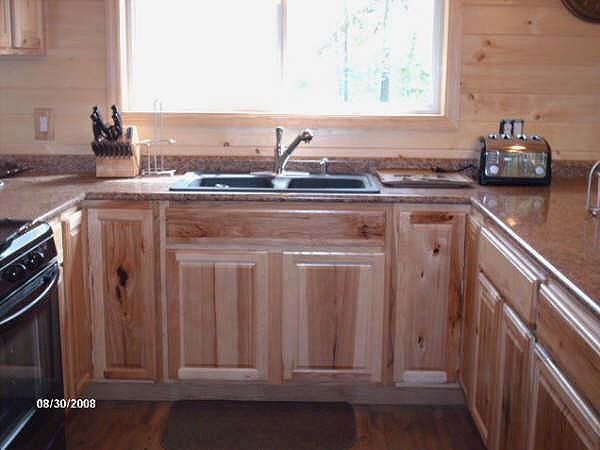

kitchen looking out the big window
Kitchen looking out the big window.

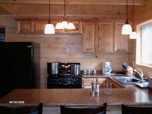

kitchen looking over the eating bar
Looking over the eating bar.
