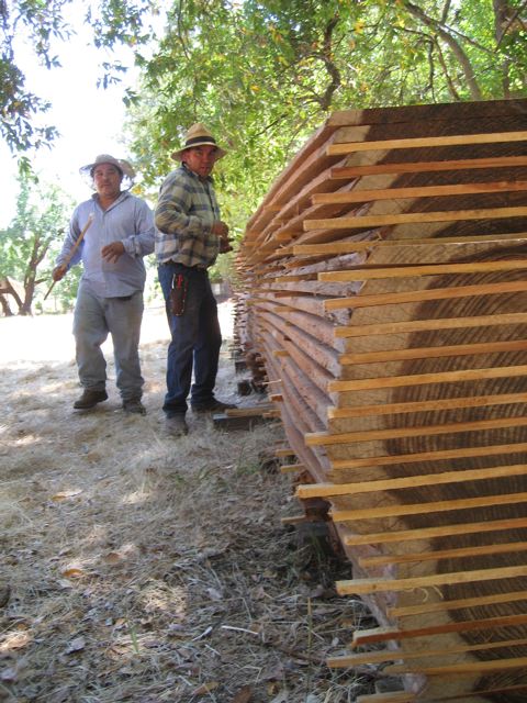

a tall stack of freshly milled redwood boards stickered outdoors to dry
Soon to be siding.

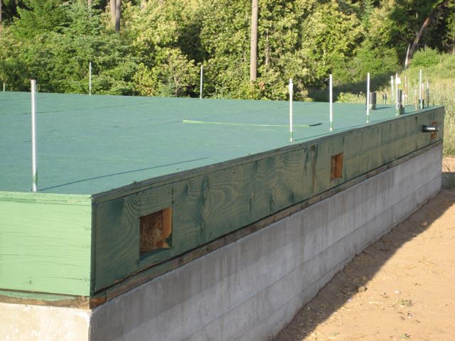

the 20x30 floor platform framed and decked over its concrete stem wall foundation
The floor platform.

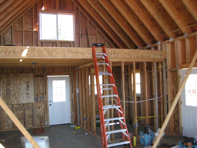

inside the shell with the loft floor framed and decked, front door already hung
Loft framing.

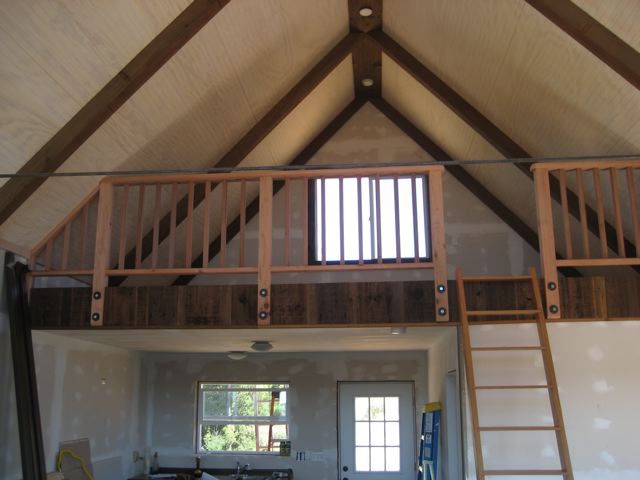

the finished loft behind a wood railing, with a ladder up to it and the ceiling boarded
Loft after insulation and drywall.

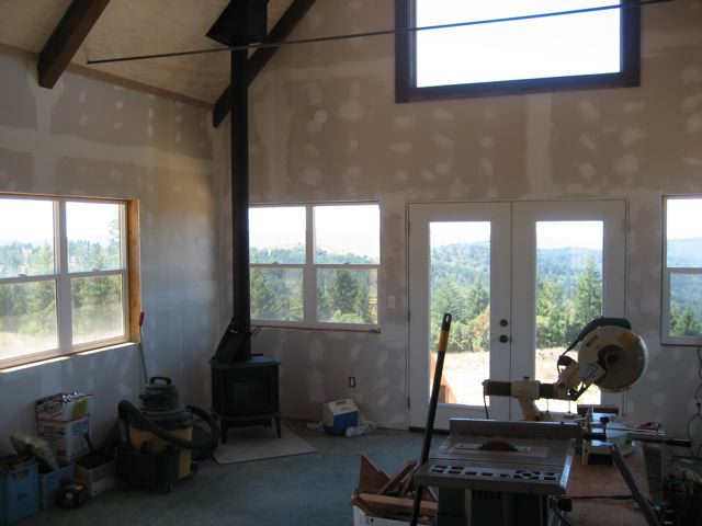

main room with drywall up, the woodstove and stove pipe in place, windows out to the ridge
Drywall going up on the interior. Stove in place.

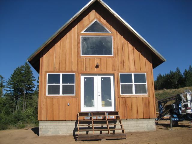

gable front of the finished cottage in board and batten redwood siding, with french doors
Front of cabin

The framing was all done out of used form boards I purchased which we used both for forming the footing and then for the framing. For the price of a few extra saw blades with all the cement... we saved quite a few bucks on the framing package. We built the walls flat on the floor and lifted them into place with the Back-hoe in one day. The Bath tub was a old flower planter I refinished with a Home Depot 2-part epoxy kit. We will see how long that lasts...
The siding is all redwood from three trees that came down in a slide on the property. Milling was the easy part, getting the trees out of the gully was a different story.
