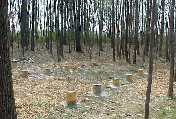

Foundation
Because of deep cold in this climate, the owner used poured concrete piers for his footers. From owner Brian Wing:
“The building inspector said I had to dig 40" to the frost line, so I did. I first made 10" dia. X 6" footers (I put an anchor bolt in the center) using cement tubes cut down. I made these in my basement over the winter. When I finally got the holes dug, I put crushed stone in the bottom for a base, then the concrete footers I made, then I put a 4’ long x 8" dia. cement forming tube on top of that. Filled it up with cement and put a bracket in the top of it before is hardened. It turned out great.”

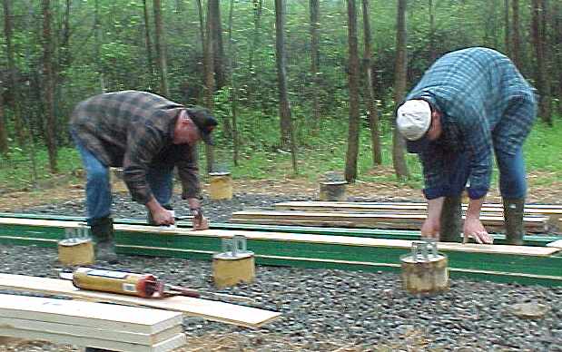

Beams
two men bent over a built up beam on the crushed rock, working between the pier tops
You can see that the owner spread crushed rock over the underfloor area of the house. This keeps things clean and retards weeds. Here Brian and his father are building the beams. They are using 2 LVL composite beams spliced together. These will sit in the saddles of the pier footings.

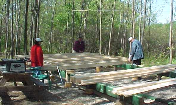

The floor joists
three people laying floor joists and decking across the beams, with a chop saw set up at the left
Now things are starting to take shape. The floor joists are going up.

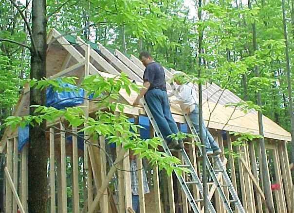

Sheathing the roof
two men on ladders nailing sheathing onto the roof rafters of the framed cabin
With the exterior walls and roof rafters in place the crew is moving along quickly.
