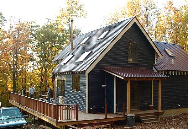

finished two story cottage with dark siding, a standing seam metal roof and a long entry deck
The entry deck side

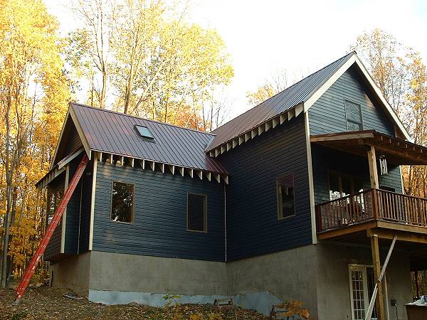

Here are some new pictures showing the outside. We are about 3 weeks from being completely done. I can’t wait. Anyway these show the deck fairly well. The decking material is “Mangaris”(brand name) it is from Indonesia and is a project of the World Bank. The actual wood is Red Baulau, I believe.
I’m hoping to take a complete set of inside out photos once the yard is finished (this week) and the inside is done.

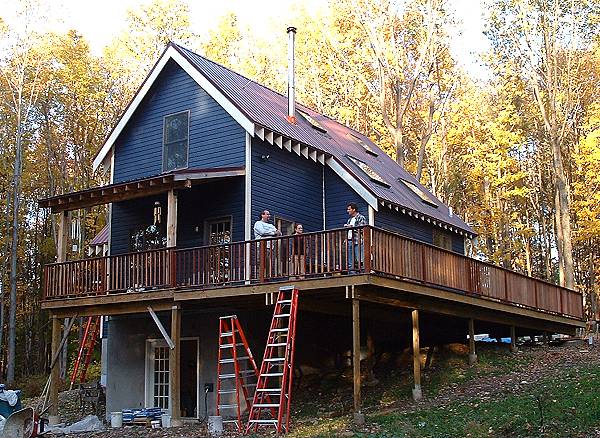

the deck carried on posts across the downhill side of the house, over the walkout basement
From below.

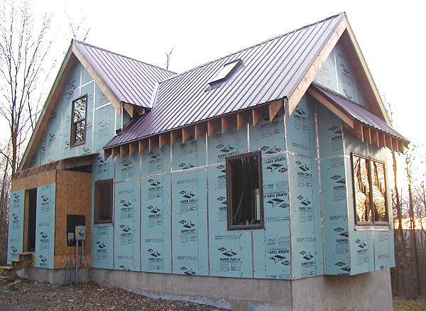

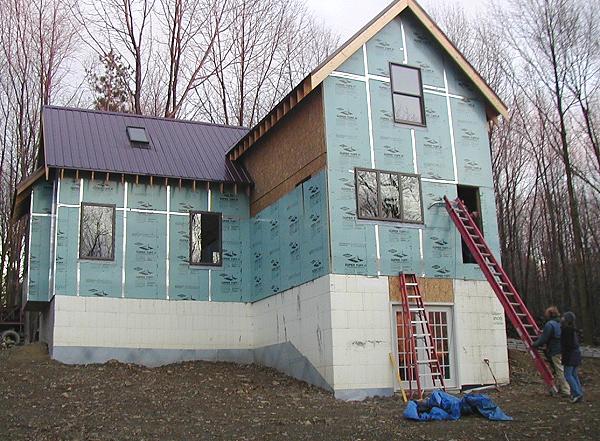

exterior insulation in place: taped foil faced board over the wall sheathing, above the white ICF basement wall
Here you see us finishing the blue board on the upper walls. It is an optional exterior insulated sheathing for upgrading the wall insulation. It goes over the structural sheathing (OSB). We used Super Tuff-R by Dow, it is 1/2" thick and rated at R-3.3. It is easy to put up, but if I had to do it again I would probably go with the 1" just because it is the same amount of work to put up 1" as 1/2" (and doubles the R-value). All seams are taped.
The windows are all Anderson casements with the exception of the lofts which are tilt wash double hungs. (Photos above and below.)

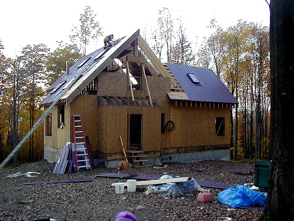

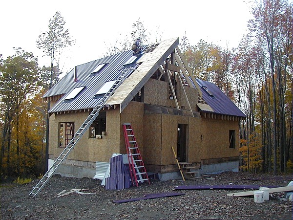

metal roofing going on over the loft framing, with a worker in a safety harness near the ridge
Installing a metal roof with a safety harness.

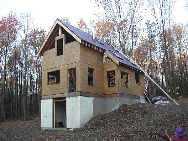

sheathed two story shell standing on the ICF basement, with the walkout opening on the downhill side
Full basement with walk-out for sloping property

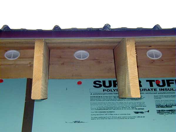

Venting Details
In a cathedral type roof you need to have a ventilation channel under the roofing and extending from the eave to the ridge. Most inspectors want to see 1" or so of airspace for this venting of heat and any trapped moisture. These ridge and eave vents need to be screened to keep out insects and bats who will otherwise set up housekeeping.
Most of our roof uses 2X12 rafters and we cut our vent blocks from the same material. We ran the blocking through the table saw at 45 degrees on the top so it would hit the roof flush (12:12 pitch). Then we drilled a 3" hole, inserted a plastic vent with screen on the outside face and caulked the edges of the blocking as we put it in.
vent blocking between the rafters at the eave, each block drilled for a round screened vent
On a 2x6 rafter you might use shorter blocking and a couple of 2" vents.

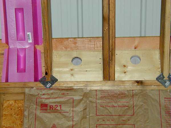

venting channel and blocking seen from inside, with foam baffles stacked at the left and R-21 batts below
Viewed from the inside, you can see the “Raft-R-Mate” we use to keep the insulation away from the vents. I think we are going to use these all the way up the ceiling. This allows us to stuff the insulation in tight and still keep the required ventilation channel.

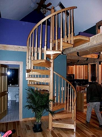

oak spiral stair winding up to the loft, with the kitchen behind it

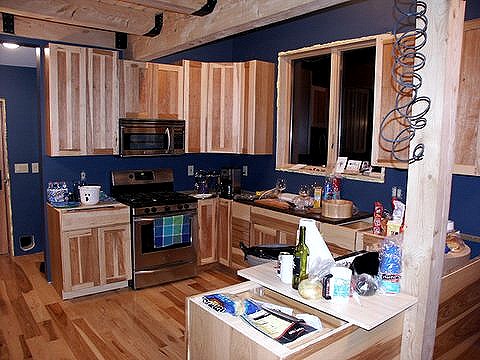

kitchen with hickory cabinets against blue walls and a hickory floor

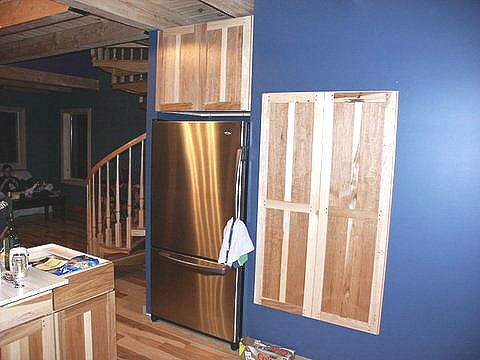

storage wall beside the refrigerator, with a matching hickory cabinet face built above it

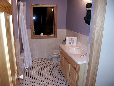

bathroom with tile wainscot, a hex tile floor and a wood framed window over the tub

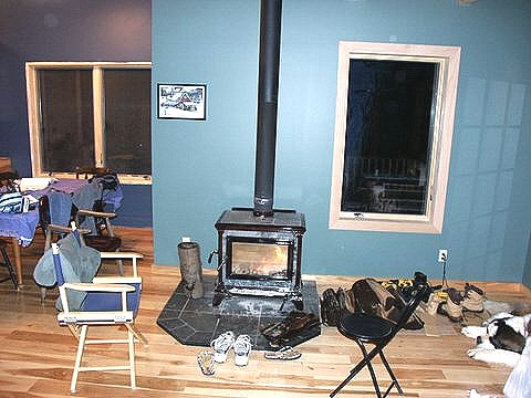

soapstone wood stove on a tile hearth against the living room wall

The wood floors are 3/4" hickory. We got the material prefinished and it went down fairly easy. The wood floors are throughout the first floor with the exception of the bathroom.
The cabinets are made by Medallion and are also hickory. I’ve included a picture of the refrigerator to show the cabinet next to it. We had the cabinet company build a face only to match the other cabinets. On the inside I built a pantry over the top of the stairs where it heads down to the basement. This modified basement stair is between the bathroom and kitchen on the standard plan.
The Oak wood spiral stair is a all wood “code stair” with a 5 foot diameter. We bought it from Salter Industries in PA. The wood stove is a Hearthstone, Heritage. They are made in Vermont. It is a soapstone stove.
