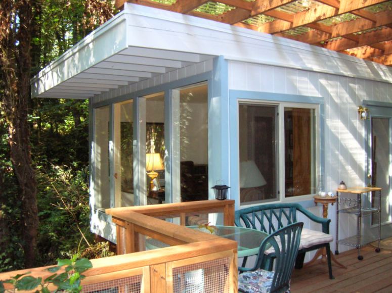

the finished 12x14 home office with a shed roof, seen across the deck
Here you can see the finished project with the deep shed roof rafters supporting the plexiglass covering for the deck. That way you can get between the office and the house without getting wet!

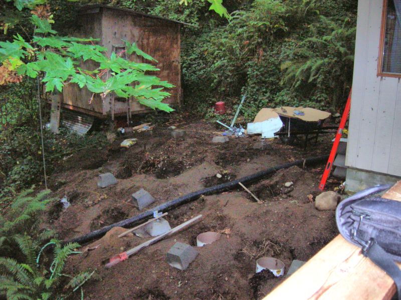

footings and a drain line going in on the wooded slope beside the existing house
Getting footings in place for the office and the deck extension. Main house and existing deck is on the right.

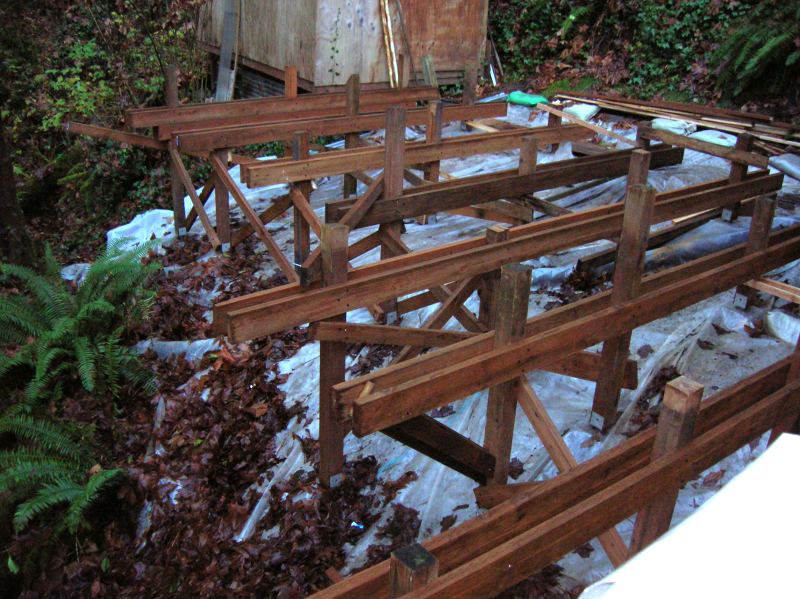

posts, braced bents and main beams framing the deck over the slope
Getting in the posts and main support beams.

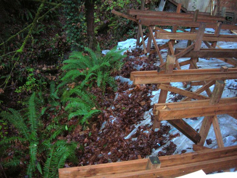

the deck framing standing above the fern covered drop into the ravine
Can you see the steep drop-off?

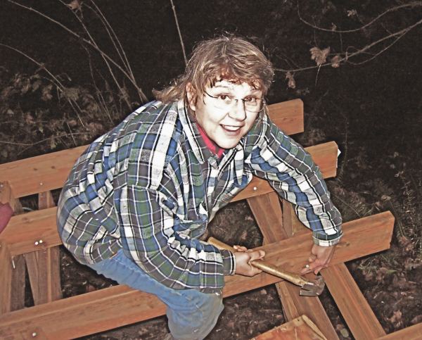

the owner nailing off framing at the outside edge of the deck after dark
Working in the dark is fun!

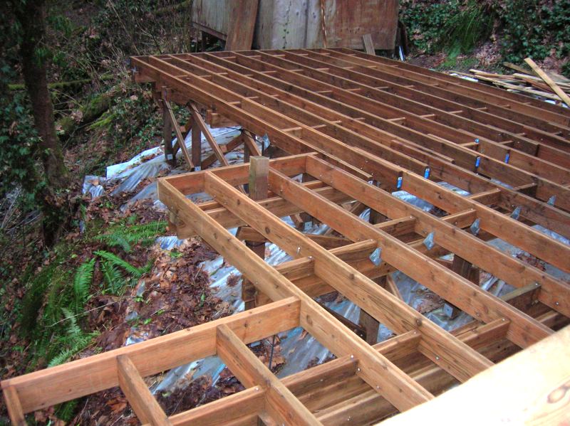

joists in place for the office platform and the deck extension
Platform for office and deck extension almost complete.

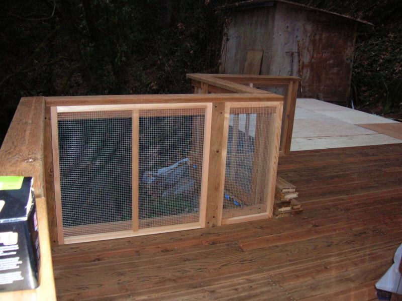

new deck railing with wire mesh panels, and the plywood subfloor down for the office
New railings on the deck and the subfloor platform down for the office.

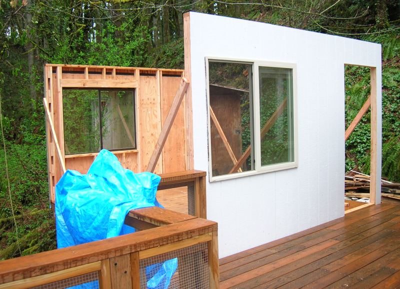

two walls of the 12x14 office standing on the new deck, windows already in
Side walls of the 12’ x 14’ modified Little House are up. The roof will be a low-slope shed.

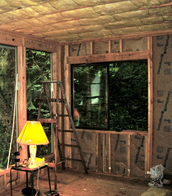

the inside of the office with batt insulation in the walls and ceiling and two big windows
Lots of nice big winows let in the light. Insulated and ready for wall board.

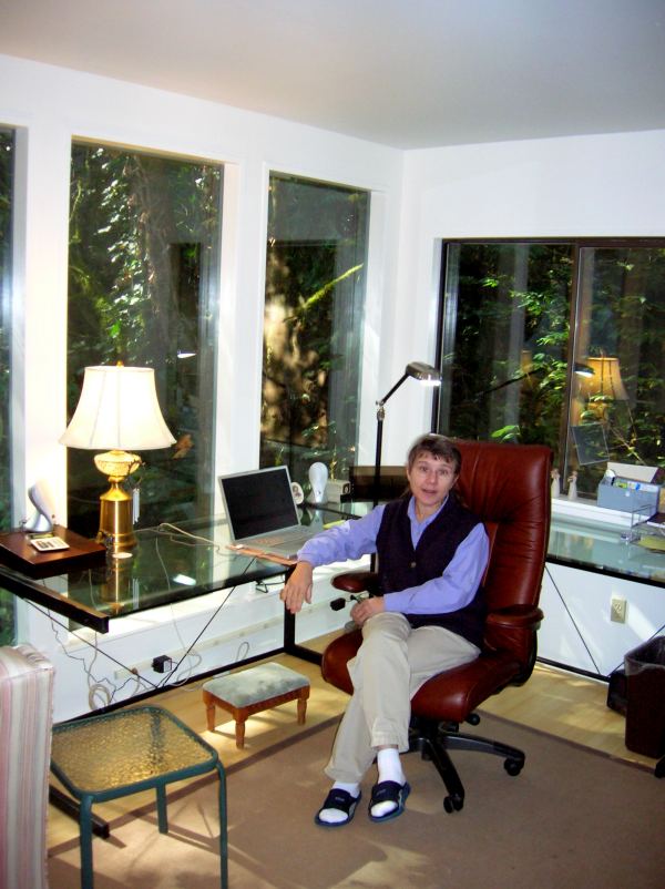

The finished office
the finished office looking in from the entry door, with a glass desk along a row of tall windows
Now we have a functioning office!

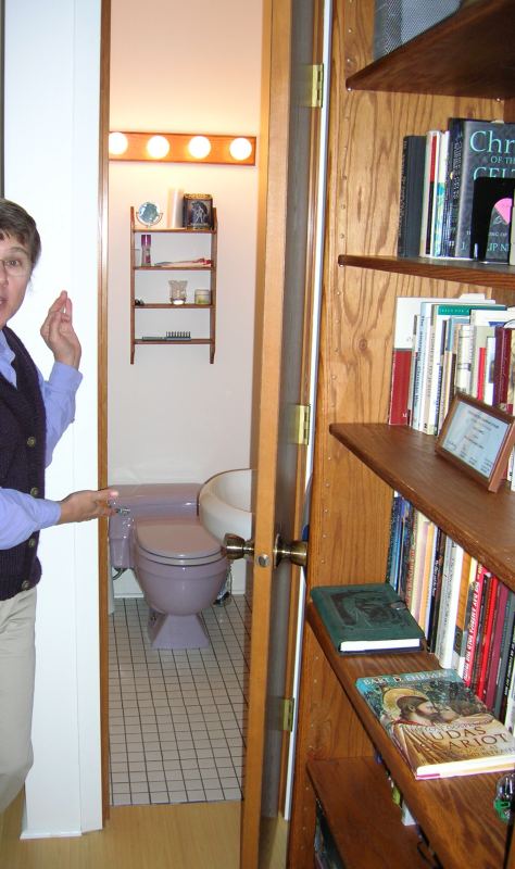

the small bathroom built into a corner of the office, seen past a wall of bookshelves
My tiny bathroom.
