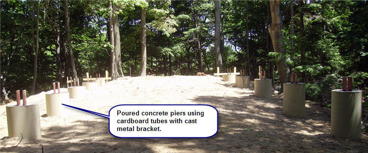

sonotube pier foundation for a 20x34 two story cottage

Let’s start with the sturdy post and pier foundation.
This home is being built in Michigan.

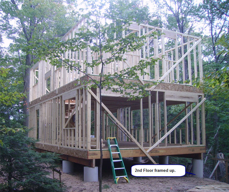

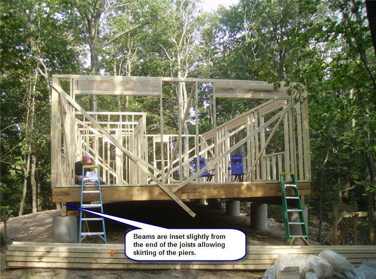

engineered I-joist floor system with the first floor walls going up
Here you see the engineered (I-joist) floor system and the first floor wall framing.
first floor walls completed on the 20x34 cottage
This is a view with the walls completed.

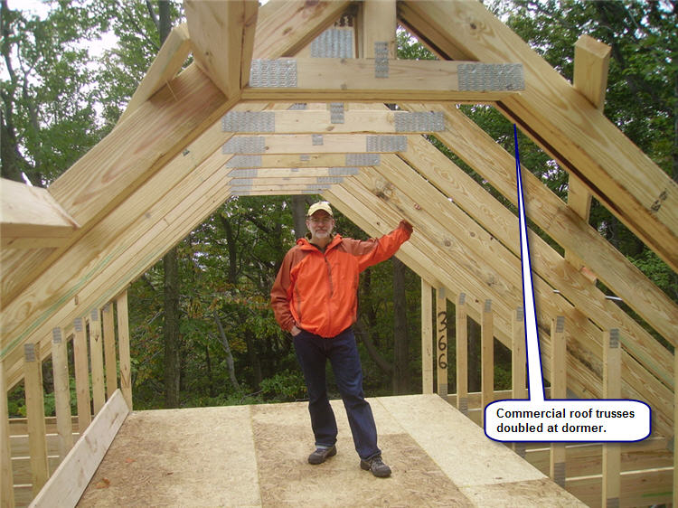

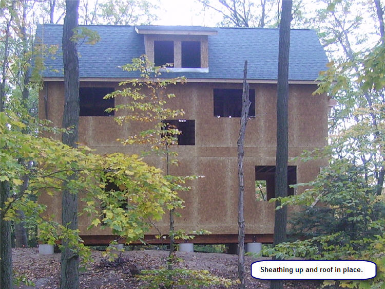

roof framing and the attic dormer nearing completion
With the attic floor decked the roof is nearing completion.
Here’s what the owner has to say.
“The only changes we made to the plan are in the sliders & some different windows, and the dormer to the attic. This allowed us to stack a stairway to the attic over the stair to the 2nd floor. This is the best decision we made in the process of building. The attic space is great and will be really useful as we have no basement.”
With the dormer over a wrapped stairway the attic can be insulated in the rafters and sidewalls and provide additional living and storage space at low cost.

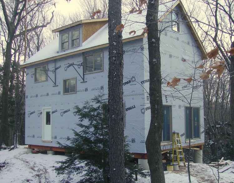

20x34 Universal Cottage closed in for the Michigan winter
Buttoned up for the winter...

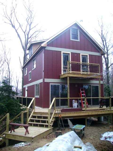

Here’s the latest report from Darrell and Deb:
“Sorry to be so long in getting back with you. We have made a lot of progress in the past 10 months. Deb and I did all the insulating, then hired out the drywall. That was finished in early June, so the summer was busy with painting, floors, doors, finish electrical and plumbing... The siding is nearly completed, along with finishing the decks and hanging the balcony. That should be done in the next week.
We continue to be very happy with the plan in every way. The space is working out very nice. As you can see we are keeping it simple (we built a kitchen stand for sink/counter and used the base from a hoosier cabinet in the kitchen). We have electric heat and the wood stove to keep us warm, but didn’t get the underside of the cabin insulated and winter has come early here in Michigan, so I’m not sure how much progress we will make over winter. Need to install trim, door handles, ... lots of little stuff to do, but that should go quickly in the spring. Next summer will be all relaxation.
A few details, We used commercial tile in the bathrooms, mud room and under stairs (where the pressure tank and water heater are located). We installed laminate flooring up and down, purchased on sale at Costco, and it turned out really nice. We went with pre-painted cement board siding. It cost us a bit more, but has a 15 year warranty on the paint, and 50 year on the material, so we should be maintenance free for a while.”

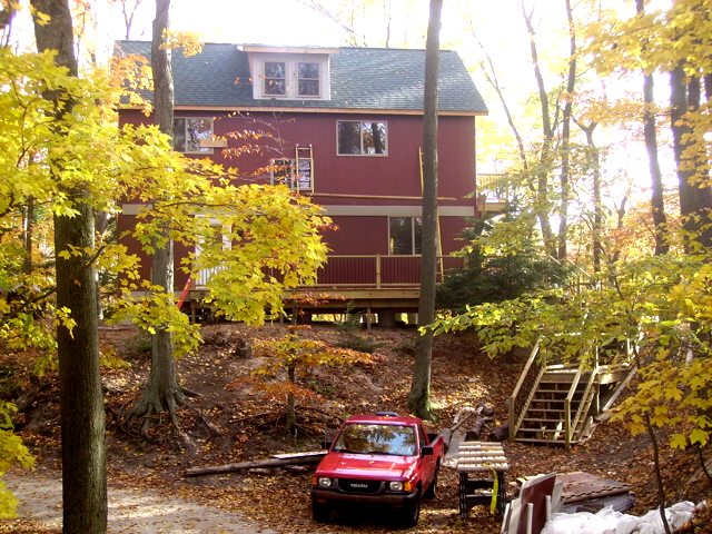

20 foot wide Universal Cottage sided in cement board with a belly band trim
Cement board siding trimed out nicely with a “belly band”

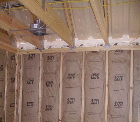

vent baffles for the roof insulation in the attic living space
Here you can see the vent baffles for the roof insulation for the living space that was built into the attic.

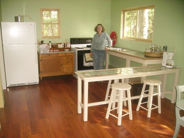

simple kitchen in the Universal Cottage
A nice clean job for a simple kitchen
