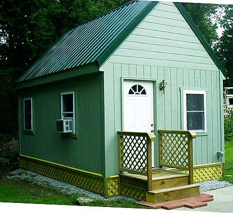

A Gable Roofed 12x18 Office and Workshop
owner-built 12 x 18 cabin workshop office
Owner Builder John Doane Reports:

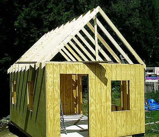

Last summer I used your plans for a 12X18 small building and built an office/small workshop for myself in back of our house. The office is equipped with computer and all the peripherals, air conditioner, loft with bed, and all my computer books. The workshop has all my small tools and storage for table saw, workbench, air compressor, and much more.
12 x 18 plywood sided cabin-office - roof framing up
The cabin uses single-wall plywood (T1-11) siding. The roof rafters are completed and ready for sheathing in this photo.

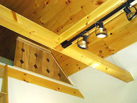

loft and ceiling finish
Looking overhead we can see the loft and boxed in rafter ties. The ceiling is finished in pine boards.

The owner’s final comments:
Although I have had some experience as a carpenter’s helper, my real job is a band director at the Derry Schools in New Hampshire. I found your plans easy to follow and I accomplished the whole building, except for help with electrical, by myself.
I thought you’d like to know that your plans and ideas for your small buildings, from the ground up, were a time saver and just right for someone with limited experience as a carpenter.

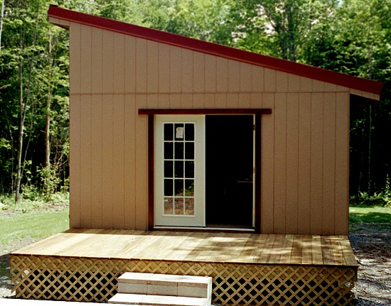

A Shed Roof on a 16x24 Cabin

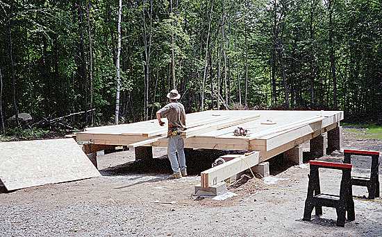

16x24 cabin framed with a shed roof and beams extended for a future deck
Kevin used concrete block piers for his foundation. He has modified the size of the basic plans and carried the beams forward to support a 8' future deck.

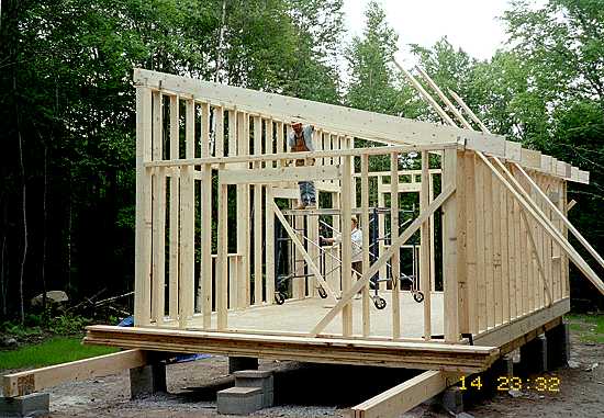

framing of the shed roof cabin
Kevin’s construction notes:
All the walls up and starting on the rafters. The rafters are 2x10x20. I use simpson strongties and birdsmouth to connect the rafters to the top plate. Using scaffolding on wheels helps here. The roof is 3-12 pitch.
roof rafters framed at the 3 in 12 pitch on the 16x24 cabin

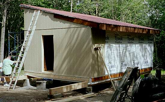

We put up up sheathing (1/2" OSB) on the roof followed by metal roofing (ABC). For the walls we used Tyvek house wrap over the studs and then sided with SmartSide panel siding. This siding is a single wall product that looks like T1-11 but is OSB on the back and it comes primed and ready to paint. Nice product and cheaper than T1-11. Their web page is: www.smartsideonline.com.
This cabin is in Northern Vermont.
All this was built in 7 days with myself my uncle, mother, and Grandmother.
Update: December 9, 2005
Kevin sent in this photo but says his project is still in process (interior work remains).
